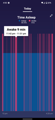

I've noticed a lot of issues with my Sense that seem to be related to the scanner. It doesn't track my sleep well. If I wake up at all, it stops recording. So when I wake up I have 3 or 4 chunks of an hour or more instead of my whole night. Sometimes not even that.

Sleep tracking is based on motion. When you review your time asleep, you're seeing a big pink bars? Can you share a screenshot? I've never seen it off by many many hours like you're stating.
Tapping the pink or blue tells you how much time is in it. I truly did wake up at that time and it was pretty accurate for how many minutes.
It's actually been objectively tested compared to EEG readings and the Sense and other Fitbit devices are actually very good at sleep tracking. Although there is a post here of people having issues with it even tracking at all.

The problem is I've already gone through and corrected my sleep logs. So they don't look how they do when Fitbit just logs it itself. Usually what it does is give me the blue and pink bars like it does when it only tracks a few hours, but in like 3 logs for one night. I'll delete the later two and update the first chunk to have my full log and then it'll have just the pink bars but the right 2/3 of it is empty because it hasn't updated yet. It usually takes a couple days and then it fully updates and looks normal. I don't understand why it doesn't just do that in the first place. I don't want a retroactive sleep log. I don't want to know on Tuesday how I slept last Saturday.
It also effects my readiness score and health metrics. If it added up each chunk and put the total into those scores then I wouldn't be upset. But it doesn't. It takes the first 2 hours and just slaps that in there and calls it good enough.
