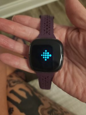

My sense shows the logo on the screen for 5-10 seconds, then disappears giving a black screen. Then 5-10 seconds later, the logo appears again. This cycle continues over and over.

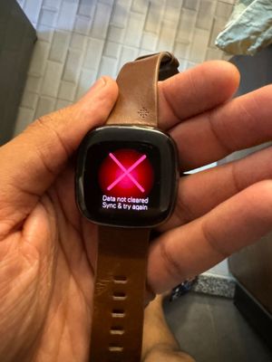

Hi @MarreFitbit ,
thanks for your reply. I have done as per the instructions you sent but I found a message as attached photo.

Mine started this two days ago out of no where. Was working fine and then it started doing the endless loop. So frustrated.
