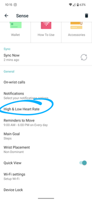

Thanks for the details and screenshots provided, as well as your efforts while working on this matter. As you may know, your Sense will receive this notification whenever your heart rate is outside of your high or low thresholds while you appear to be inactive for at least 10 minutes. This feature will appear as an installed app in the Gallery where you can either turn on or off the permissions. However, you'll need to go to your profile picture > Sense > High & Low Heart rate to adjust the settings there, and then tap Gallery > High/low heart rate app > Settings to sync any change.

@Hgraham1987 Thanks for trying the suggestions shared in my post. I'm sorry your Sense is still not receiving these notifications and just to confirm, did you make sure to adjust the High & Low heart rate settings? To do this, just open the Fitbit app, tap your profile picture > Sense > High & Low Heart rate. For any reference, check the screenshots shared by @eezeepee and @JohnnyRow before.

You can reach that same High & Low Heart Rate by, clicking on your face on the app main screen, Click on Sense, and see High & Low 3 down on the General list.  In either one you can use the system settings or do a custom.  I did a custom to 60 to see if I get a notification later when I'm relaxing before bed.
