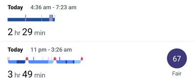

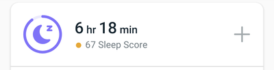

03-02-2022 11:46 - edited 03-02-2022 11:46
I had a pretty rough night last night. My 8 month old kept waking up. The pink awakes were right at the times I had to get up. And my Sense was smart enough to split my sleep up.
Yet it still added them together on the Today screen.
