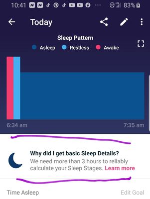

Please look under your simple sleep graph.
IE:
If it's not a length of sleep problem, it could be a heart tracking problem.
Have you tried changing the sleep sensitivity setting? As far as I know you can only do this in the fitbit dashboard on a desktop browser, not in the app.
