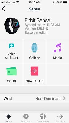

Here is how I finally did it on my Iphone fitbit app. Starting on Today view > Click on wristband icon (upper left corner) > Sense > Gallery > Apps > By Fitbit (click view all) > Weather > scroll down to Settings > Unit > change C to F. Don't forget to "sync" after making change.

There is no such category as GALLERY on my IPhone Fitbit Sense. And cannot find a Weather app on it either. ????

Clicking on the Sense Icon under Account should get you here.
