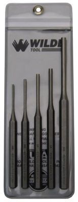

Then I used a hole punch (picked mine up at Walmart, a whole set of them for around $10 - any hardware store should have them)
Here's a pic of hole punches:
https://www.menards.com/main/tools/hand-tools/punches-nail-sets/wilde-tool-reg-pin-punch-set-5-piece...
Pick the correct size hole punch, set screen protector on a scrap block of wood (or something you don't care about wrecking as it will go through the screen protector & cut into whatever is underneath it), put hole punch on mark and hit with hammer.
