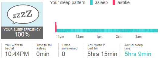

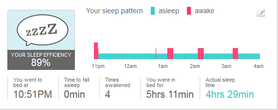

Best AnswerThe setting for Dominant vs Non-Dominant hand would be more for the step counting, because you would move your dominant arm more when you are not walking (I think). For your sleep tracking, the Fitbit is working off of your movement. On normal it disregards slight movements that show up on the sensitive setting. You can look at the same nights results with both settings from your dashboard, your amount of sleep didn't change, just the amount that it determines you were awake. The only way to determine if you were truely asleep or awake is by measuring brain activity with a sleep test. I have had three sleep studies and in all of them they said that I don't move.
Here are my results from last night:
Sensitive
Normal
