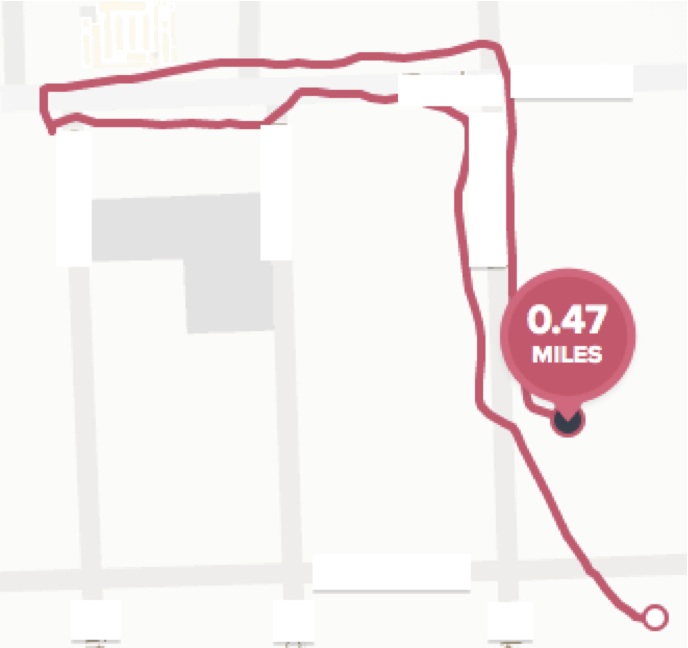

I have a (new) Surge and when I look at my Dashboard, the GPS location always has either the wrong starting point, the wrong ending point or the path has me somewhere I wasn't (like in somebody's kitchen).
This is true on 100% of the times I have used the GPS. On almost all activities, the start is in the wrong place. A few times it was blocks & blocks away. Then, a diagnoal line will connect me to a certain place actually on my walk or run. The path and/or ending point are also often wrong whether or not the start point was correct.
I sometimes also have gaps in the route. As far as I can tell, it isn't a dead zone because other walks in the same place will have no gap. But, I understand each day has different signal strength form weather, etc.
Part Two is that I can walk or run, for example, 1 mile. The report on dashboard will be much less or much more than the mile. And, the reported distance does not necessarily match the GPS mapped distance.

Attached is a screen shot of a very short walk. I apologize for not having one with more errors to share, but I deleted these from my activity list before I thought of asking you all.
The attached map should have the starting & ending points in the same spot. (Where the ending spot is shown)
The starting point is off, but not by as much as usual.
And, this one has me doing the u-turn at the wrong place. I was 3 blocks farther away when I turned back.
On this activity, I watched the tracker to see if it paused or something else. All looked normal.

Hello there @EnjoyToday! I'll be happy to work on this with you. I also want to thank you for providing us with the details and the picture of your issue. I'd like to recommend that you restart your Surge tracker. This will help to fix any issue your tracker may have. Some times high buildings, trees and weather may cause an interference on your GPS signal. Please let me know if you're still having issues with.
