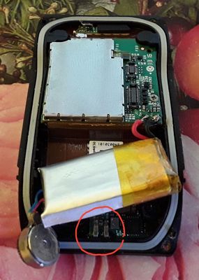

Okay, in the end, I opened the tracker to replace the battery, because it merely makes 8 hours of work. And I saw a lot of oxidation on the contacts of the Bluetooth antenna:
Decided to clean them by carefully scraping with a small knife. The result is that I broke the copper traces that are connecting the board with the antenna and basically left myself without an antenna.

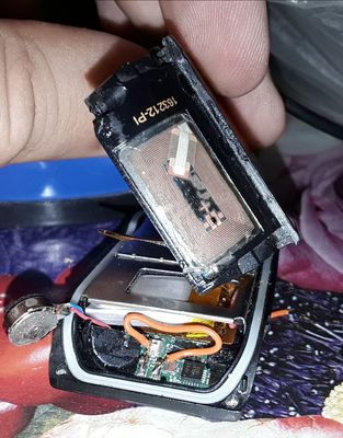

So, decided to make an improvised antenna soldered directly to the circuit board with some wire:
It worked. About an hour. Then it stopped connecting and nothing that I read and tried helped. I thought that I damaged the Bluetooth radio by putting an unmatched antenna. So I gave up.
But! Later I thought a little and decided to try something. I shut down the tracker and left it for about an hour. Then turned it on. It started working immediately and so far it works. Since then are about five days.
So, another tip: if it refuses to sync and even connect at all, shut it down and let it rest for a while. At least twenty minutes

So far it still works. With the new antenna. It glitched once, but turning off and on the bluetooth on the tablet solved the issue. Now I am a happy man.
And I noticed that the battery depletes after 14-18 hour. I guess, when the Bluetooth radio cannot fall in sleep mode, it draws some energy. In the app I turned off the "All day syncing" option, just in case. Still cannot explain why it cannot make a couple of days as expected. I guess, the new battery might be defective...
