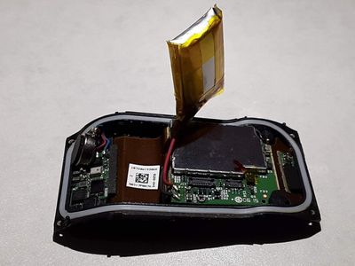

Old Dead Puffy Surge Battery
This is what happens with an older Fitbit Surge battery ...
The batteries will expand while expiring, this is a chemical and electrical reaction that impacts all LiPo batteries. In the Surge, when it expands, it will push against the electronics next to it as well as the screen above it, which is what sometimes causes issues with swiping, etc. It's hard to see from this photo, but compared to a new battery, this is 2x the normal size.
