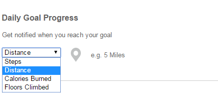

It is nice to see you around btw. Uhhhm... The first request, you can do it by putting distance as your mainly goal progress and specifically adjust it to 500 meters or whatever you want.

Hi
First, I can't find the menu's described by you, but looking at the screen-dumps, I can se that you are using a App on a Phone or so, I am using a computer/browser/fitbit.com.
But from the screen-dumps I think that the settings you are changing is the over all settings for my goal for a day. I am quite pleased with the these setting as they are right now.... Even I can't find the place to change them right now 😉
So I am sorry for misleading you in the first hand. Where I want to change the settings, is the settings for using the EXERCISE/WALK function on my Surge. The reason for this is that i want to use it for optimising my walk with interval walking, eg. 500 meter for full speed and the next 500 meter with normal walk and so on. As I wrote earlier I can't read the distance on the Surge without my reading glasses, so to turn on the buzz indication would be perfect. So now, where do I do that?
