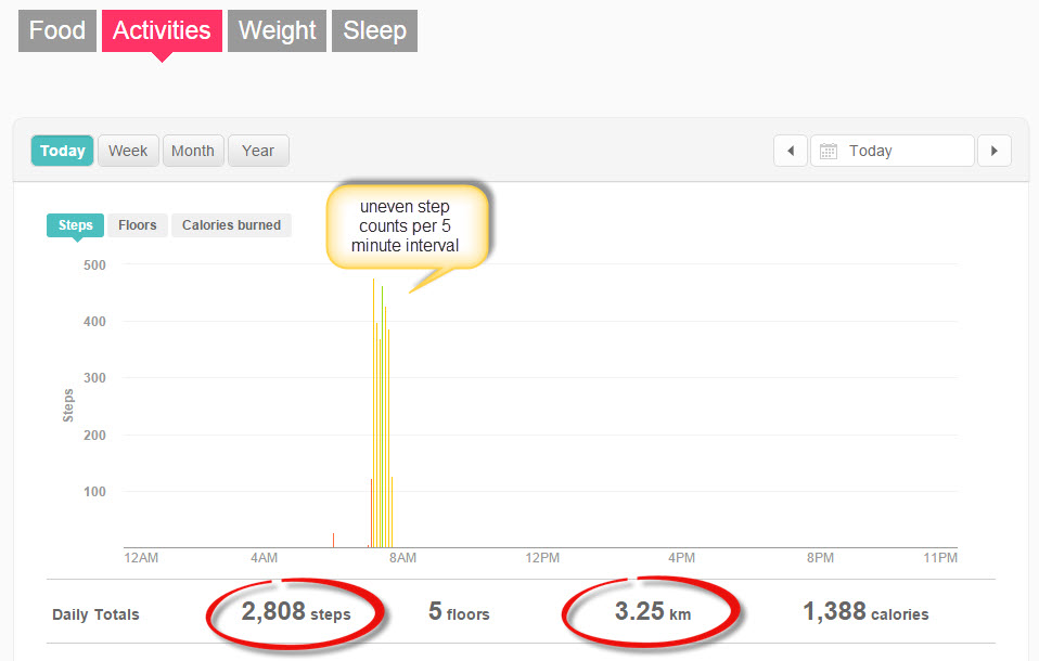

Here is a actvitiy log screen snapshot of my walk this morning.

Hi Andrea, I did reset my Surge as you suggested but it still the same - under counting steps.  Please see the activity chart snapshot I just taken.  What else should I do?  Please advise.  Thanks.
