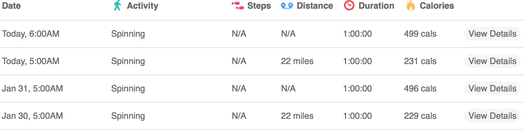

Manual logging is also off, for example I'm just over 200 pounds and I usually burn 800-1200 calories per hour while spinning at 80-90% maxHR. Fitbit finally added a new manual spinning entry, where you can enter miles which is an indicator of effort, however the new spinning entry is worse than the old one that just used time and weight to estimate calories:
The minor calorie differences between Jan and today are due to my weight being up a few pounds.
