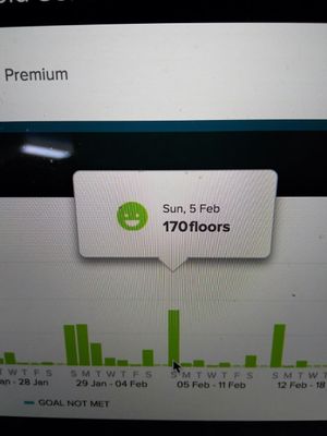

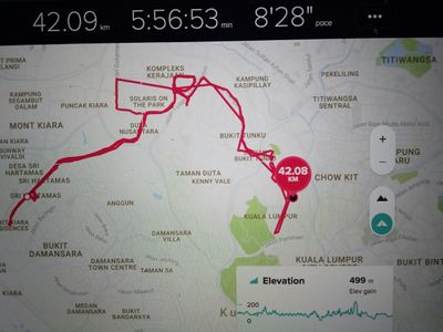

with the floors, i believe it takes into consideration the elevation climb you have from your daily moving around. i noted that on my long run Sundays which I need to clock 42km, I get 170 floors based on the elevation gain of my run route.
To get that equation, one floor is approximately 3 metres high (in Malaysia). So my 499m = 166.33 floors. Plus another 3 plus which I can account for when I walk in and out of my basement carpark when I drive to and fro my training ground.
Hope this explanation helps. I have attached the pics for you to have an idea of the elevation gain. 499m from my training itself - 499m / 3m = 166.33 floors
Sunday's total of 170 floors

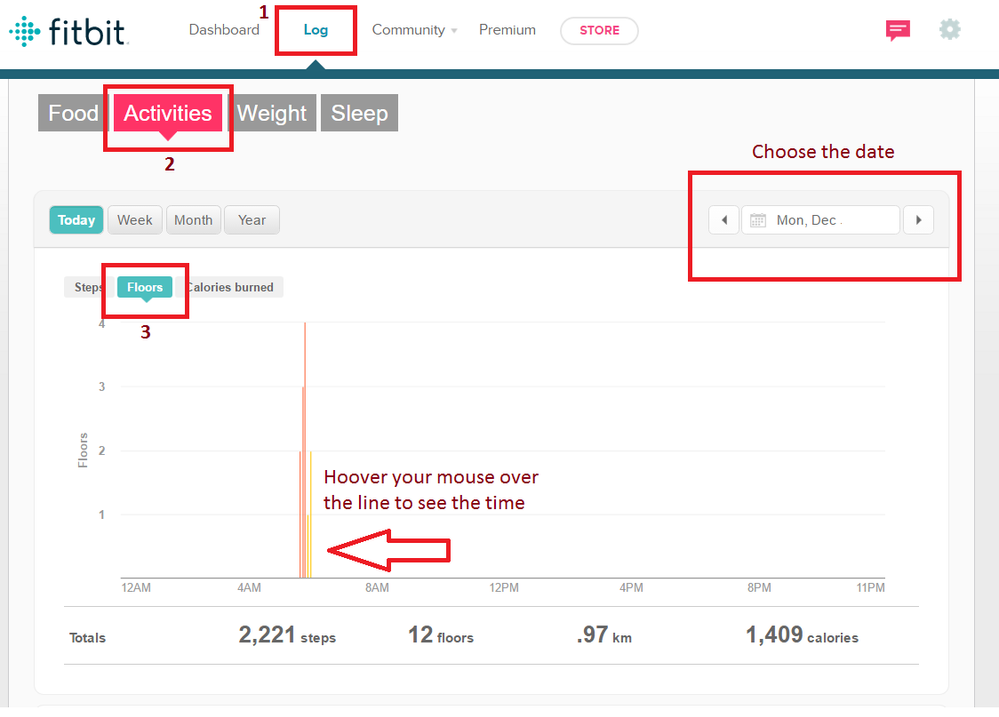

A warm welcome to out Fitbit Community family @Ken41! Good to know that you've found useful information in the Forums! About that number of floors, why dont' we check together at what time they were tracked. Please open the Fitbit.com Dashboard in a computer or in your phone browser. Click on Log > Activities > Change the view to Floors and choose the date. You will get the time line of day with the information regarding floors, including time.
Please note that the tracker uses both the accelerometer and the altimeter to track floors. Algorithms interpret the raw data into a floor, and it registers a floor when it detects continuous motion combined with an elevation gain of about 10 feet. So, your thoughts about the lift causing more floors is feasible.

From looking at the times of some of the floors logged, it was indeed when I was using the lift a few times. Plus thanks for the clarification about the Surge also having an accelerometer, that explains it further.
