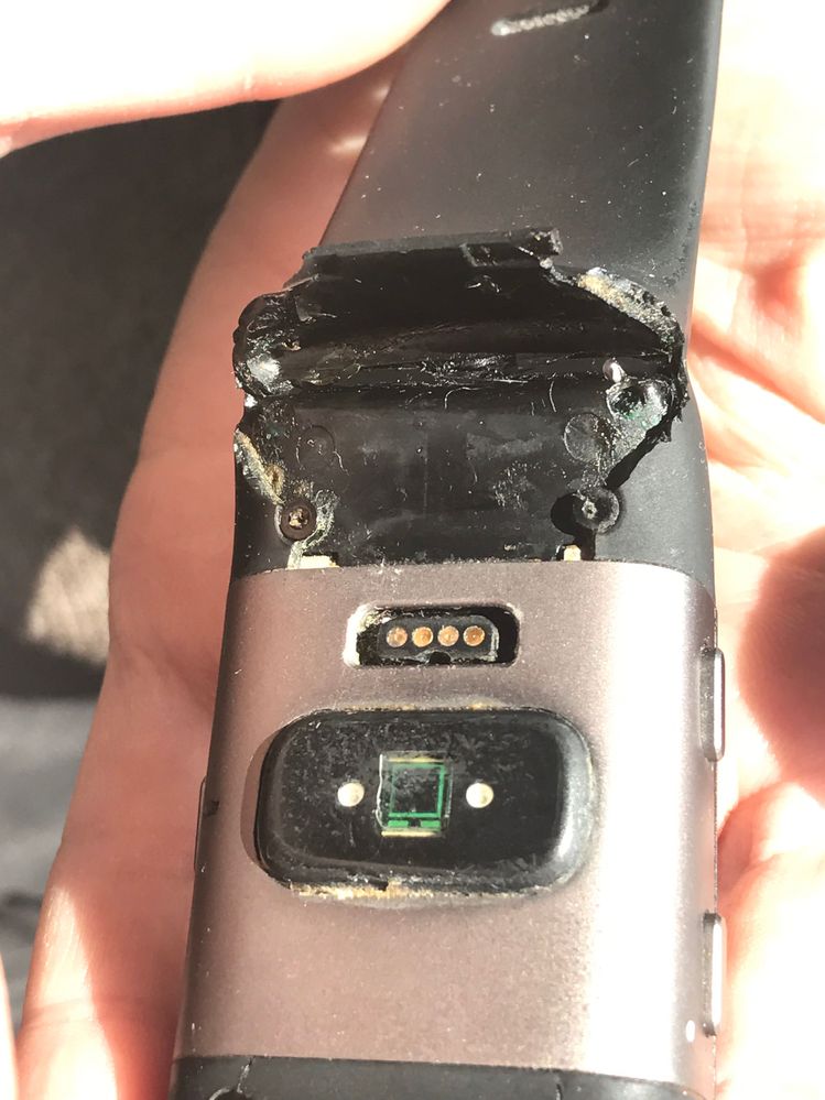

My Surge is almost two years old (purchased April 2015) and its strap has broken where it meets the case. (See pictures)
Basically, there are two tiny screws connecting a panel on the inside of the strap to the watch case. The strap broke at the two screw holes, but it did not entirely detach from the case.
I have re-attached it with superglue - let's see how it holds.

There are replacements for sale at amazon and other places and youtube video's explaining how to do the repair. I'm debating changing to a different smart watch. My son's sits on a charge plate and has a much sexier face and seems to have the same functionality. The surge charging port is becoming unreliable. when that happens, i have to shop for a new one, the discount code is just okay.

And if you go to AliExpress they'll sell you a new strap, including the Torx Screwdriver you need to fit it for around $20 USD.
You can buy a whole load of new straps for the cost of a new FitBit, even with the 20% discount.

Same happened to mine. I also superglued it.....twice.

I have exactly the same problem and think that this must be a very common problem. In my case super glue did not do the trick but I have taped it with black electrical tape. It will not last much longer so will be forced to get another fitbit product just not a surge. Bad design but good software. Wish I could join their engineering team to help solve the problem.

Got my replacement band today from Amazon. The package contains a URL for an instructional video. I watched the video, and I was able to replace the band in about 10 min. It snapped in place with a bit of pressure, and seems to fit perfectly. Not sure how long it will last, but it's worth a try. It's $12 fix without which I would not be able to continue using a $250 fitness tracker - so it's worth taking a chance.
