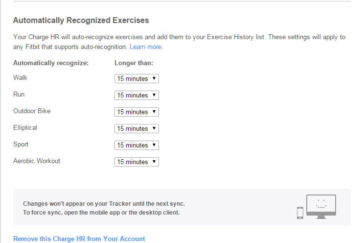

After restarting, keep an eye to your tracker's behavior and post back with the results. Now, auto detect is the SmartTrack feature and it's available on your Surge to automatically recognizes and records select exercises to ensure you get credit for your most active moments of the day. It should look like this from your Web Dashboard:
It also recognizes continuous, high-movement activities such as:
  • Walking
  • Running
  • Outdoor biking
  • Elliptical
It also recognizes two general categories:
  • Sport—Includes high-movement sports like tennis, basketball, soccer, and others. Sports that might not be recognized include those without continuous movement or that vary in intensity level, like golf.
  • Aerobic workout—Includes aerobic activities with continuous movement, such as Zumba, cardio-kickboxing, and other dance classes.
If after verifying all that you feel that your tracker is still not accurate, please contact our Support Team. They definitely have the proper tools to take a deeper look into your tracker's behavior. Good luck!
