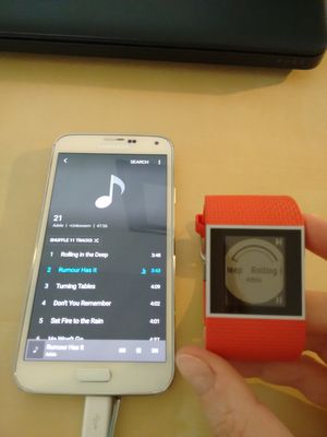

Thank you Solange. I don't have a problem controlling music on my phone with the Surge, except the information on the Surge doesn't update when I change the song currently playing. I use the Samsung Music app. I attach screenshots to demonstrate my problem.
Step 1 - first song is playing, Surge matches the app

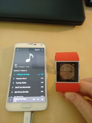

Step 2 - press the fwd button (top right), second song is playing in the app but Surge is still showing the first song

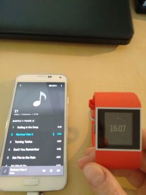

Step 3 - the Surge screen goes off after about 15 seconds

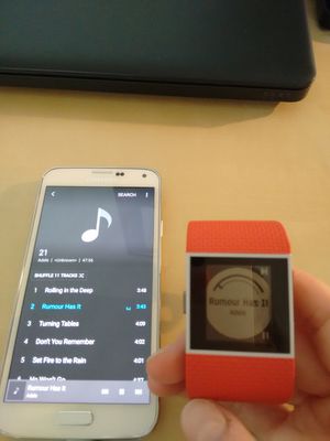

Step 4 - I double press the home (left) button and Surge screen now shows the correct song
Sorry about including so many images. I hope this illustrates the issue more clearly. It's nothing to do with pairing, Bluetooth works fine, except with the information being sent back to the watch doesn't seem to be instantly updated. In the first six to nine months of using Surge for music control I did NOT have this problem. This is a quite recent development, perhaps the past 3-4 months.
Thanks, Klara
