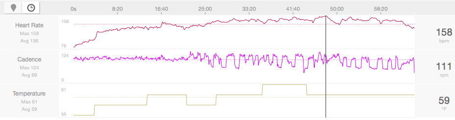

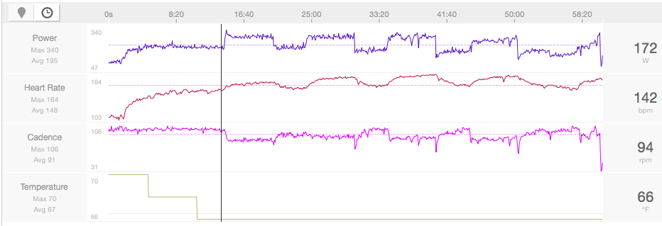

You can absolutely record spin rides with an app or device (e.g. Wahoo Fitness app, or Garmin Edge), export as TCX, and then import into another app/service (e.g. Strava or TrainingPeaks). For example below are two spin rides recorded with Garmin Edge. First on a spin bike with power/cadence sensors (HR from chest strap, temp from Garmin Edge), and the second from a bike without sensors (cadence on shoe pod, HR chest strap, temp from Garmin Edge).
Spin bike: Power Intervals workout. Recorded with Garmin Edge, auto-sync into Strava:
Spin bike: Cadence Intervals workout. Recorded Garmin Edge, auto-sync into Strava
Example TCX trackpoint: Recorded Garmin Edge, output as TCX from Garmin Connect
