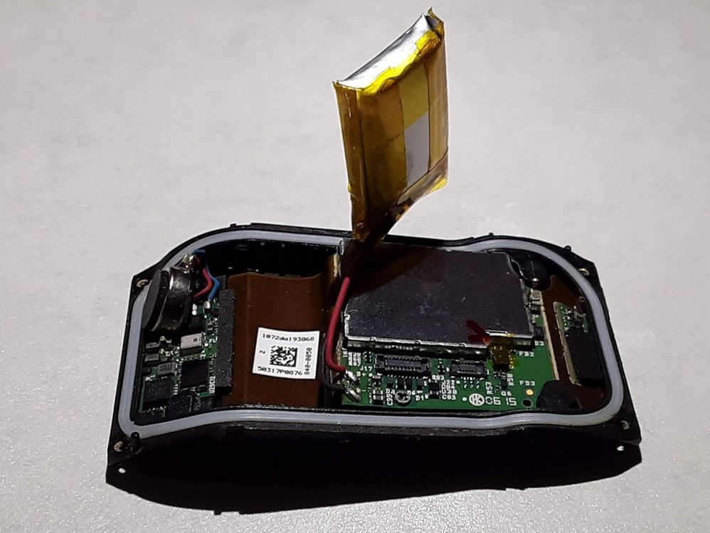

@vTro7an that's odd, you should have all 3 options (pair, on, off) but these, as @Rich_Laue mentioned previously are for controlling music, I've never had to turn on "pair" to actually connect a Surge. Although newer Fitbits benefit from pairing to the device's Bluetooth, with older models, I've never seen a difference, meaning I can connect a Surge to the app with or without adding it to my Samsung Galaxy's Bluetooth devices. The battery life can be improved by reducing sync frequencies and turning off the display backlight, turning heartrate to auto, turning notifications off, etc. Eventually, though, these batteries that were rated for 3 years will die. I'm happy to walk you through replacing the battery if you're comfortable doing so. The battery can impact other parts of the Surge functionality from heartrate to screen swipes. Can you share more about syncing through the data cable? I've worked on hundreds of Fitbit Surges and haven't ever synced using the cable, only Bluetooth.
Old Dead Puffy Surge Battery
New replacement Surge battery
