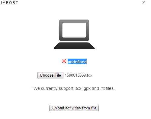

any suggestion?
thanks,

Did you export a Fitbit GPS activity? In the Fitbit world, to export TCX your activity *must* have GPS data.
Unfortunately Fitbit has crippled TCX export utility. So if you try exporting a Fitbit activity without GPS, you get an empty file.
01-25-2016 13:07
01-25-2016 13:07
yes, I exported a running activity.

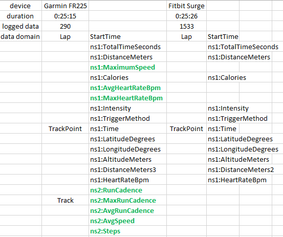

here's the different of tcx(actually xml) file exported from garmin connect and fitbit,
probably the missing part of fitbit is the reason?

fitbit logged 1xxx points of data, while for same activity, garmin fr225 only logged 3xx points,
tcx file size, fitbit gave 7xxK, garmin 2xxK,
another concern might be the average and maximum I "made" for fitbit, when import, does garmin connect verify them?
