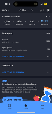

I have done the same amount of steps today as yesterday, but the calories adjustment is about 300 higher - too high for the 13,000 steps. Usually get about 500 calories but at the moment it is showing 841 for exercise. Is anyone else seeing this and know how to fix it (apart from adding an extra 300 calories of food on MFP)?

Yes - same happened to me yesterday. I reconnected Fitbit to MFP and it was wrong in the morning but by the end of the day it had reduced and was right. Same this morning - saying I have burned 871 calories of excercise when should be about 100 so far. Will see if it evens out during the day.

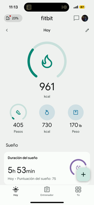

It looks to me that fitbit is including my whole BMR for the day first thing in the morning. That's why the calorie burn sent over to MFP is so high in the morning. Even in Fitbit, when I look at the "food" tile, it will show 1221 calories burned for every day this week even though it is only Monday. How can it know in advance how much I'll burn tomorrow.
If that's the calories burned being sent to MFP, instead of the actual calories burned, then I can see how the value is so high early in the day.

Today I haven't really moved yet, only done a couple of steps around the house (754 to be exact). And in MyFitness Pal app, this translates to 884 calories. That doesn't make any sense. I've used another calculator and according to my weight and size, it should be 23 !
Does anyone know why this is happening?
Thanks !!
You're right! I realized the morning that the problem is on Fitbit too, because it's showing like 1300 calories already burned for the next 3 days.

I have found with the MFP/Fitbit latest issue that if I log my food in MFP, it syncs fine to Fitbit. I like using MFP for food logging better than using that feature in Fitbit since I have lots of meals and recipes stored in MFP. Then I use the Fitbit Food tile to see where I stand for the day. That feature always took in what it thought my approx total for the day would be using some BMR data (which for me is about 50 cal/hr) even before this latest syncing glitch. I have Fitbit set to sedentary so it only adds in that BMR amount until I actually move or exercise. That allows me to stick pretty close to my 500 cal deficit. I have that deficit in my goals in both MFP and Fitbit. That allows me to ignore the "calories left" and "exercise adjustment" in MFP.
Hopefully the Fitbit people will get the WebAPI fixed at some point.
I have found that if I look back at previous days, the total calorie burn in Fitbit and the calories for the day in MFP are pretty close. So I suppose it is syncing up pretty well by midnight.
We might need to contact support (fitbit and/or myfitnesspal). I have noted the same as well as someone else in these forums. MFP will report some much greater number of calories (that it said came from fitbit) than the fitbit app actually shows, so one side or the other is screwing up the count. This seems to have started sometime between August 9 and September 4. It is not just for the Charge 6.
Also I noticed that for completed days, the total shown for Fitbit calories in MFP seems to match the total shown in the Fitbit app. So it seems they must have made some change how it estimates your full day burn during the day.

Hello @Emilie_S & @bobdob
There's a bug affecting calorie tracking. The issue has been escalated and the team is working on a fix. Hopefully, it won't take too long before the fix is rolled out.
