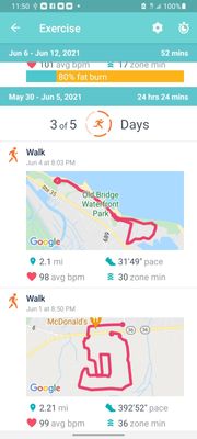

On the app, tap the exercise tile, it will say something like 2 of 5 days
You should see an event in the list with a map. Tap this event.
