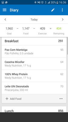

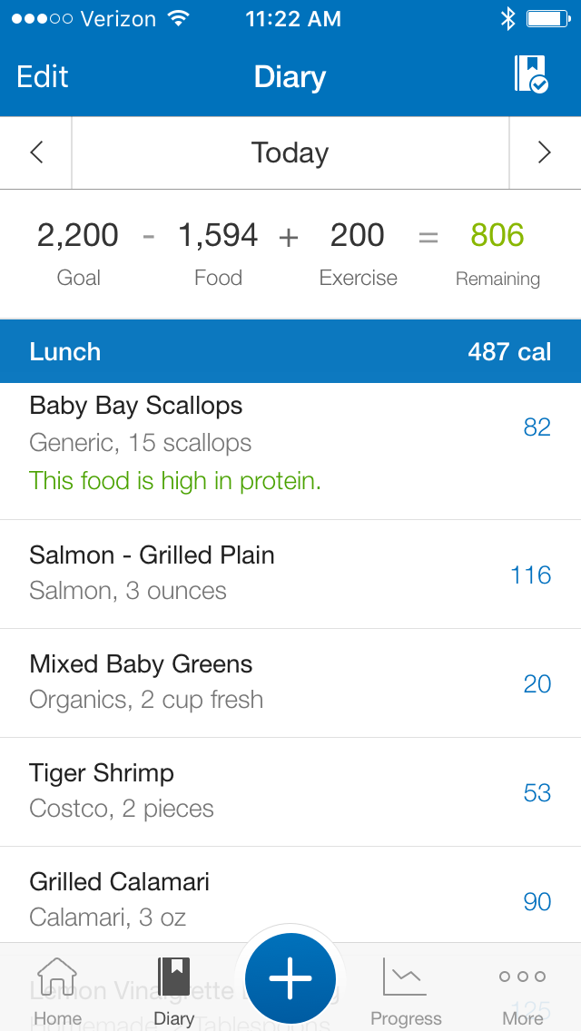

1. I am editing both ways. I changing the quantity of a single food item and I am changing the food item all togher. Adding and removing single lines of food that make up the meal.
2. It updates normal on MFP side. Here is a screenshot.
I have no other apps linked to FitBit, just MFP.
MFP Lunch

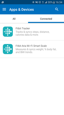

I only have Fitbit and Aria linked to my MFP account:

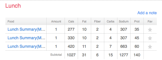

Here you can see the duplicated meal entries for today:
Here's the MFP screen:
Breakfast is duplicated with increasing amounts of calories, as you can see. I logged 3 items, and a couple of hours later logged the last one.
Hope this is helpful!

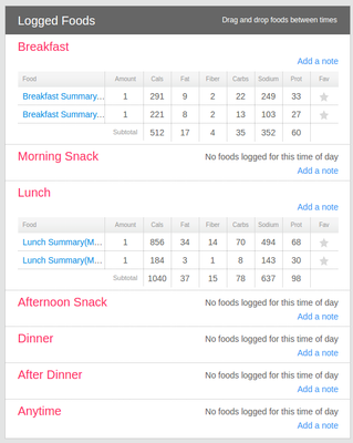

@crmiles14 Okay, I see what's happening now. Duplicates seem to show up sometimes when you "Add Meal". It logs a bunch of food items all at once in MFP, but then these food items are not always cleanly sent over to Fitbit.
For example, I created a meal with the food items shown in your screenshot. When I quickly added that meal under "Lunch", I watched my Fitbit food log as it updated. It synced over a few of the items and saved that as a summary, then it sent over another item (adding it to the previous items) and saved that as a separate summary, finally it sent over the last item which did the same thing (added it then saved as a separate summary). Here's what I ended up with:
So since the items are technically grouped as a "Meal", MFP might be sending individual items within the meal, and then also sending the entire meal itself.
