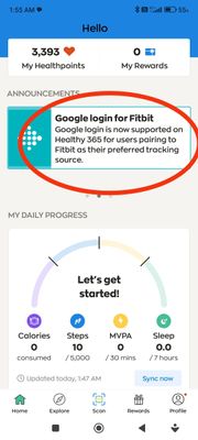

Here are the issues
1. All new users require using Google account for Fitbit account
2. Singapore's Healthy365 App allows the step counter in Fitbit to work with it and gain points if we are active.
3. The Healthy365 App just recently gave a notice that the "Healthy 365 App does not support Facebook and Google Log in currently.
4. I have tried and it says the (internal browser) cookie is not enabled and I cannot log into Fitbit via the Healthy365 app.
Basically I am stuck between a rock and a hard place.
Am I able to revert to Fitbit Account rather than Google to circumvent this issue?
1 BEST ANSWER
Accepted Solutions
H365 updated to support Google login now.
 It work fine now.
