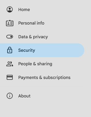

Here are the steps.
0. Install the Fitbit App and link your tracker to fitbit app first to make sure it works. As of now the only way to register is using google account.
1. Go to www.google.com You will see that it is a search page but that is not what we are after
2. Go to the top right corner with your profile picture if you already logged into Google Account before. If not, Sign In with the same Google Account as in step 0.
3. Click your profile picture
4. On the left bar you will see security and click it
Step 5. Go to "2-Step verification" and turn it off. Google will ask to verify you again. Once you are verified, click the blue button to turn it off
Step 6: Go to Healthy365 App. Log in and then follow instructions in the user guide for setting up other fitness trackers.
https://hpb.gov.sg/docs/default-source/pdf/h365-set-up-fitness-tracker-userguide.pdf
Step 7. When you prompt Fitbit trackers, there will be a login page. Use the google login that you use on the fitbit app.
NOTE: Again, make sure you are using the same Google Account as the Fitbit App
Step 8. It should be linke and best to initialise the first sync between Healthy365 and the tracker.
Step 9. Use the tracker for 2-3 days and synch at the end of the day to make sure it works.
Step 10. Go back to google account and turn on 2-step verification to secure your google account.
