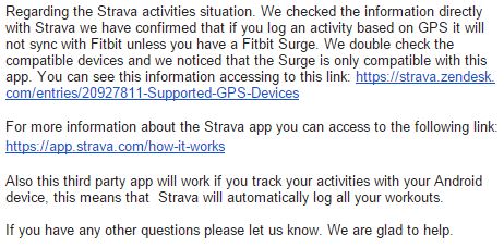

Add me to the list of users that are unable to sync Strava rides to Fitbit. I have contacted Fitbit support and I recieved the follow response via email:
They misunderstood that we aren't trying to push data to Strava, rather pull data from Strava, so the device shouldn't matter. I replied specifying this, so we'll see if it goes anywhere. @MatthewFitbit I told the helpdesk person to contact you if they are unsure about what the specific issue is.

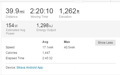

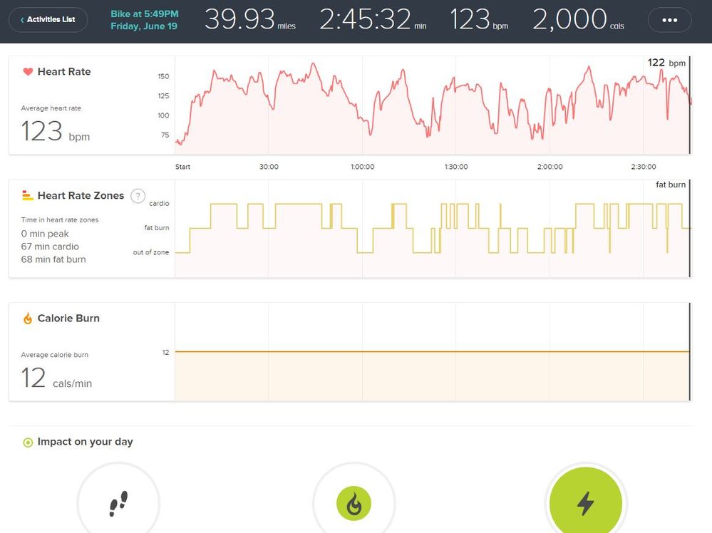

A couple questions for users that are successfully syncing rides:
  1. Do 'fake' steps recorded during a bike ride get deleted from your daily total once Strava rides are synced? Or are you adding calories from both your ride and the 'fake' marathon you just ran?
  2. Calories differ between Strava and Fitbit (Fitbit is usually higher). Is Fitbit calculating a new calorie burn based on the imported Strava data and the HR data from your Fitibit device?
Strava Data
Fitbit Data (Imported)
3.  Is there supposed to be GPS data imported from Strava even in you have the HR? This is all I'm seeing      on my dashboard
