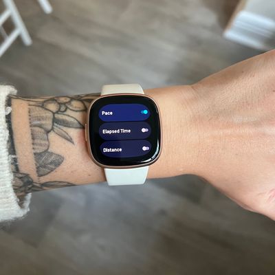

@hawkec You will need to follow @MarreFitbit instructions and then you’ll be presented with options to set the stats you want to see. Here is what it looks like on my Versa 4 and you can toggle different stats on and off.
Heather | Community Council | Eastern Shore, AL
@hawkec Just to add, when you start a run for example, you would tap on the screen to cycle through the stats in the middle. The top and bottom stat does not change, but by following the instructions above, you can set whatever metrics you want to see. I have my top running stat as Distance and the bottom as Elapsed Time. For the middle, I have chosen to see Pace, Pace Average, Heart Rate, Steps, and Time of Day when I tap the screen.
