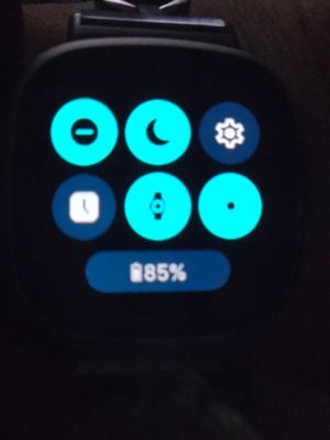

I am NOT able to turn off do not disturb or turn off sleep mode. Though both should not be able to be on at the same time they are. I have restarted my Fitbit about six times with no change. I have changed my clock face twice with no change. I have adjusted my sleep and wake times in the app with no change. I have synced and unpaired and repaired my phone and my versa 4 twice with no change. My firmware version is 61.20001.210.26
From other posts I've read it seems like my option at this point is to do a factory reset. Is this my only option?

Hi there, @wkeeler. Welcome to the Fitbit Community Forums. Thanks for bringing this to my attention, for the troubleshooting steps you've tried, and for the image attached. I understand your concern, I will do my best to help you with this!
Since you've exhausted all steps we could've provided here, I'd recommend a factory reset as our last resort. Important: Take into consideration that a factory reset deletes any stored data, which includes all data that hasn't synced to your Fitbit account and your applications, alarms, etc.
With the above being said, please press and hold the button for about 8 seconds until the screen turns off and vibrates. When you feel the vibration, release the button, then immediately press and hold the button again. Wait for the Fitbit logo to appear, then as soon as the logo disappears, release the button, then press and hold the button again. When you feel the vibration, release the button, then wait for the watch to complete the factory reset.

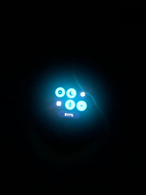

I have the same problem. I restarted it but problem remains.

same issue, is there any other methods can be used here other than factory reset? I don’t want to reset it!!!!!!!!!! 😞
