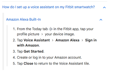

as of Alexa, there is Alexa installed in Versa 4 watch but I am asked to "complete setup it Fitbit  mobile App and sync device". However, I am unable to find what is mentioned in Fitbit Help Centre shown below. There is no "Voice Assistant" under my device image (which is also not under my profile picture).

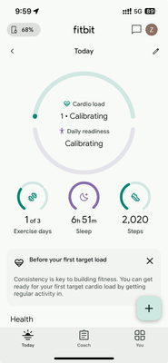

This is how Fitbit app “Today” looks like in my mobile which seems different from the description above.
Could you advise on this please?
