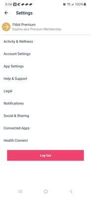

First, if you select your picture you will get a drop down menu, select fitbit settings.
go to notifications here and make sure they are all allowed.

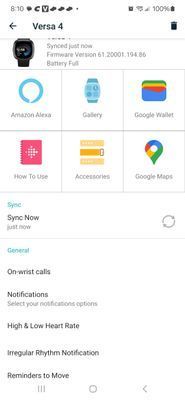

Now, part 2, go back to your main screen in the app and tap the top left corner that shows your battery status.
you should see your connected devices. Now, tap the versa 4 and you will see another window with notification permissions as an option.
Select notifications and you will see and/or be prompted to allow notifications.
Turn on the ones you want and you are good to go.
