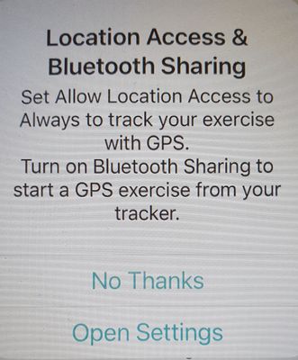

Currently thinking that if i start tracking from the watch itself, it'll use the on board one, but if i want to use the phone's GPS, do I need to instead start tracking from the fitbit app? If I do that, will it still pull in HR stats etc from the watch?
I'm android not iphone - but do you get that popup when you start the exercise from the watch, or if you start it from the app?
