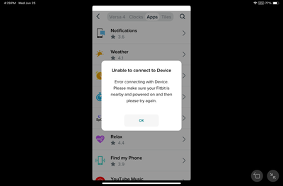

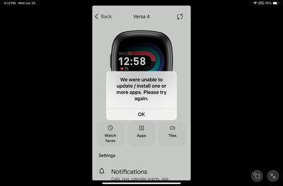

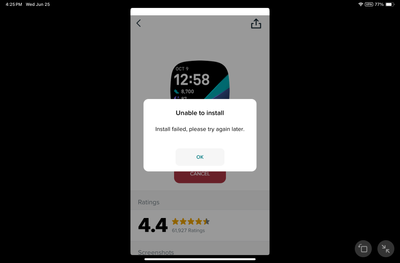

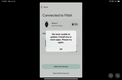

I am having the same issue. Had the black screen, button doesn’t work, tapping the screen does nothing. Never saw a notification that the app needed updated but I did finally see that and updated. I have tried all the shut down and restart procedures. Bluetooth on and off. “Forget device” multiple times. Do NOT like the big red X !!!
I have no idea what changing the clock face would do. After 4 or5 tries I finally got one downloaded. Looked like everything was working - paired with the app, connected, synced and then everything disappeared. Again. Why? Because silly me thought I could take it off the charger and put it back on my wrist. Like a few other people said - as long as it’s on the charger, it seems to be fine as soon as you take it off you’re back to blank screen again. And round and round we go. This makes absolutely no sense why it suddenly just stops.
