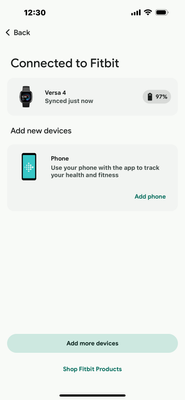

Can you please check if you have "MobileTrack" activated? MobileTrack is a Fitbit feature that uses your phone's sensors to count steps when you don't have your Fitbit with you. It's possible that the steps recorded on your phone overwrite those on your Fitbit devices.
Here's how to turn this feature off:
  • In the Fitbit app, tap the device icon (top left).
  • There you'll see the devices paired with your account.
  • This option will display as "Phone", tap it and then select "Disconnect device".
Additionally, please check if you have the newest version of the Fitbit app. Here's how to update it depending on which OS version your phone has:
Disconnecting my phone still has not resolved my issues at all.
