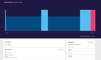

My versa 4 used to track my naps perfectly even when they are under 2hrs though like the documents mention, the deep/rem zones were not measured.
But yesterday and today they were not detected at all. Not sure if it is a firmware / software update, though I didn't notice any. Is this a change or something wrong with the device?
A secondary problem is that when I manual log the nap time it magically breaks it down to 3 zones it track normally for shorter naps. This seems like a bug ... perhaps this what it does for all short naps, just make up zones?

Thanks. Didn't know about the "begin sleep now" button.
As for my problem, my versa 4 started tracking sleep again. Perhaps the watch was too loose on the wrist or it was some other one-off problem.
Upon closer reading, yes, 1hr is when it detects sleep. It need HR measurements for 3hrs to construct full sleep stages (Awake/REM/Light/Deep) - and only with newer devices which track HR continuously. So in the 1-3hr range it breaks down sleep into Awake/Restless/Asleep buckets, not standard sleep stages like in the image I posted above.
It is possible that it record wrist movements all the time and use that to backfill those buckets when someone log sleep later. Perhaps I could log fake naps for times I was doing different activities and see what it does.
