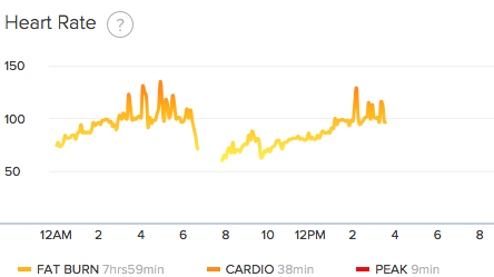

I am continuing to have problems with my Versa reading a heart rate when I am not wearing it. I've owned it for 10 days and contacted Fitbit 4 times. In that time, I have done the manual syncing suggested in this thread, a soft reset, a factory reset, an iPhone app update & a versa software update based upon the customer support reps' comments. Now the recommendation I've been given is to leave the Versa with the clock face DOWN when I'm not wearing it to prevent a heart rate from recording. Is anyone else having similar issues? I was considering buying a Versa for my daughter's graduation gift, but now am distinctly uncertain. I'd appreciate feedback from others so I can figure out if this is a device problem or operator error on my part. (Below is a pic of my readings today when I wasn't wearing it & it was lying clock face UP on a piece of paper...) Thanks.
05-04-2018 13:22
05-04-2018 13:22
Just checked mine, took it off and propped it on its side. Green flashing LED went off after a few seconds.
From previous Fitbits I have, this is the same action as the "auto" setting, I think on the Versa "on" is the same as the old "auto", they've just dropped it as a separate option.
If yours continues to flash, that means it's still trying to record data for some reason. That's gotta be a hardware problem.

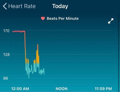

I took off my Versa 2 and meant to set it face down, but it wasn’t completely flat/level so this happened. Btw it looks like I put it back on this morning when it drops down from 170 but I didn’t - I put it on the charger.
Ive compared the Versa 2 HR with a finger pulse ox device and it’s usually pretty accurate, but this is still annoying. I’m going to start turning HR off every time I’m not wearing it.
