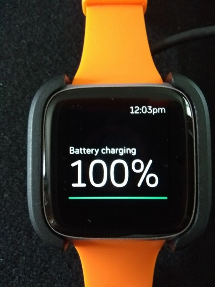

My one charges okay from a USB 5 Port Charger.
The only thing is it never says "Charged" just "Charging" and thus am never sure if the charge process has really completed. It could just be tacky programming (like the clock display ignoring the time format set in the app e.g. 24hr format).
Has charging completed?Has charging completed?
