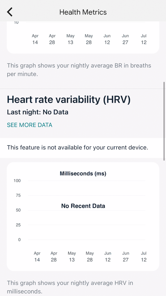

I'm facing the same issue, so thanks for the reply! Regarding the conditions for HRV data, the 2nd to 4th bullet points have been met, as the hours of sleep is more than 3 with the sleep stages log being present in the response from the Sleep Web API. As for the 1st bullet point, the Health Metrics dashboard is visible in the iOS Fitbit App (under settings > manage data and privacy > manage your data > HRV > review your data > trends). However, under each of the metrics headers (BR, HRV, Skin temp and SpO2), it states that "This feature is not available for your current device". May I know if this is what's causing the HRV Web API to return empty data, and if so, how can I resolve it?

Hi @Gordon-C, the Fitbit device I used to record the sleep data was a Charge 5; if it helps I'm also using an iPhone 12 with iOS 16.1.1 for the Fitbit app

Hi @dave_996
Thank you for that information. I'm not sure why the Charge 5 is not collecting your HRV data. Since the data is not available in the mobile app, it would not be available through the Web API. My recommendation would be to reach out to customer support at https://help.fitbit.com/support and have them troubleshoot your device.
