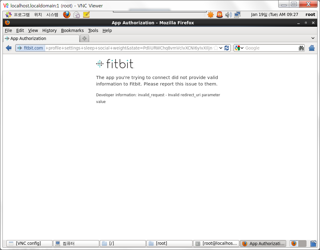

Best Answer01-18-2016 20:25
01-18-2016 20:25
Firstly you need to change your redirect URL to http://127.0.0.1:8080/
Next The script needs to be run the script with the following parameters.
./gather_keys_oauth2.py <OAuth 2.0 Client ID> <Client Secret>
Substituting the client ID and client secret for your values.
01-18-2016 20:29
01-18-2016 20:29
you mean call back URL?
Have a great day and Thanks
Best Answer01-18-2016 20:37
01-18-2016 20:37
That's correct.

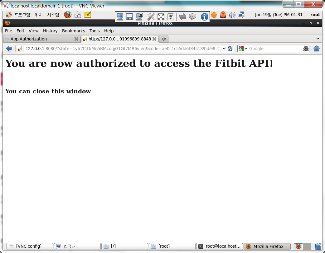

Best Answer01-18-2016 20:39
01-18-2016 20:39
success how to get my data from the CSV?
