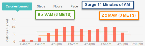

@dstarh Because the data isn't available via api, all I do is create an Activity Log and analyse the one minute graphs as you can see in the example. A pain doing it this way, but when I walk I know what my calories/minute should be to achieve VAM I aim for that even though over the time lapsed it will have it's ups and downs.
