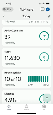

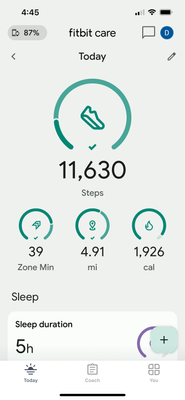

I have an iPhone 13 , iOS 17.1.2. As you can see when I opened app this
morning it says today but it is yesterday’s stats. Even all the tiles show
yesterday’s stats. I have to toggle back arrow and then toggle the forward
arrow to get today’s stats.

@LizzyFitbit I have an iPhone 13, running iOS 17.1.2. My Fitbit app is version 4.06. All of the tiles are yesterday's data. I can't include a screenshot, because I already fixed today's stats.
My husband has the same phone, OS, and app version. And the same issue.
