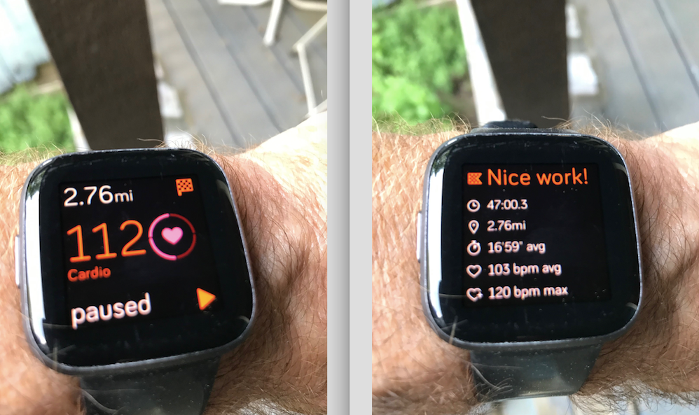

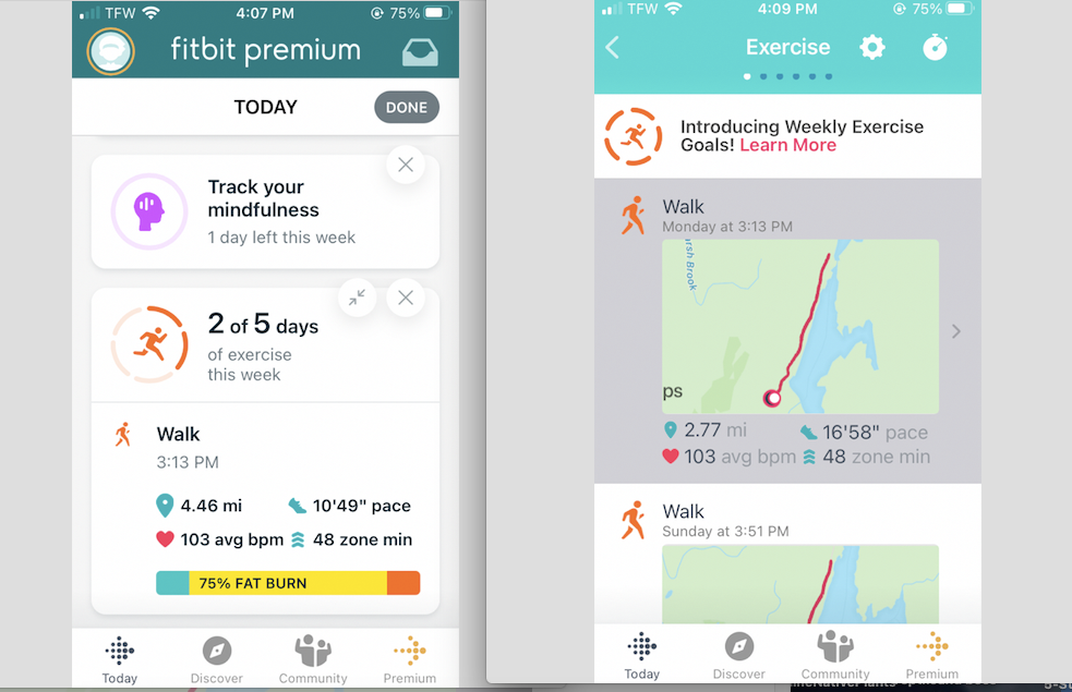

Here is my example......I have a Versa 2. I updated the ios app on the apple store on wed and since then, there is a new area on the today screen that shows your recent exercise. I don't know whose workout it is showing, but it is not mine. I will show you my results for my 2.7 mile walk yesterday. When done, the app said I walked 4.34 miles at an average pace of 9' 41"....I wish! If I click on the exercise or go to the desktop app it correctly reports a 2.7 mile walk at a 15'35" pace. This needs to be corrected.

Now screenshots.. On "today " shows 4.46 Miles....on exercise page says 2.77 miles. If I convert miles to KM by multiplying by 1.609... 2.77X1.609=4.46 KM. This is where the problem is, on the today page, it shows the distance in KM, but labels it as miles.

@gkbdvm wrote:Now screenshots.. On "today " shows 4.46 Miles....on exercise page says 2.77 miles. If I convert miles to KM by multiplying by 1.609... 2.77X1.609=4.46 KM. This is where the problem is, on the today page, it shows the distance in KM, but labels it as miles.

Just try getting Fitbit to understand this though. I had another rambling response blaming some bizarre overlap between step count and GPS. I've even referred them to this forum in the hope that someone with an inkling of common sense will look at this properly - it's more than coincidence that there is a common error (multiply by the conversion factor for miles to km) that exists for at least three users...

Yes. Mine is doing the exact same thing. Very frustrating. The KM conversion makes sense! But the Time is also off. On “today” it said I worked out for 1.0 hours but I exercise page it shows that I worked out for 37 minutes which is the correct time.

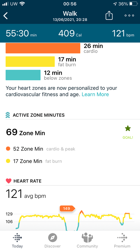

@LiliyaFitbit the bar graph does seem to be fixed, thats great. However, the graph and the amounts of minutes in each zone don't seem to tally up for me. See the attached screenshot of a walk today. Does it look right to you? For me the amounts of the different colours on the graph don't match the totals eg 26 minutes of cardio/peak (Orange) would be nearly 50 % of a 55 min walk, but the graph doesn't show that and as you can see the yellow portion of the graph looks like a lot more than 17% fat burn that it should correspond to. It's not a big deal but it doesn't make it easy at a glance to see what the exercise session really looks like in terms of below zones/fatburn/cardio. I think that the graph is more correct, which means that the amount of minutes stated for each zone is totally incorrect. This walk should be more than 50% fat burn, a small amount of cardio and possibly the below zone amount is correct. This all seems to have gone wrong since the Zone Minutes system was changed.
