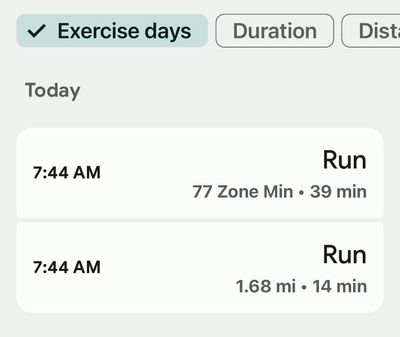

Today's Update @JuanFitbit
Below is a screenshot from today's run. It was actually 4 miles long and around 35 minutes. It shows two runs at exactly the same time and they do not add up to my actual run (I run the same course and same mileage every day so I know what it should be) I was paying attention starting right before the 9-minute mark and the Fitbit app closed on its own. This caused the screen to lock. So I was mistaken when I said Fitbit was locking my phone, it is because Fitbit is closing by itself at virtually the same time each run (approximately 9 minutes) and since Fitbit is not open, the phone locks. And while I would love to be in two places at the same time, I was not doing two separate runs simultaneously. I reported this bug several weeks ago and it did go away until this latest update.

@WeatherRich , Nice to see you around. Thank you for your messages and screenshots.
It seems that you might have MobileTrack on.
MobileTrack uses the phone's sensors to count steps. This is for when you have left your Fitbit at home (e.g. while charging). Please make sure MobileTrack is not activated.
It may happen that the steps recorded with the cell phone overwrite those Fitbit or track 2 activities parallel .

Having Mobile Track on is just one part of the problem expsed by @WeatherRich , the twin recording.

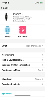

Thank you for your response. As I mentioned the last time this happened and you suggested Mobile Track as being the issue, I do not have anything called MobileTrack in my app. Below right is the screen I get when I click the upper left devices icon, below left is the screen I get by clicking on my watch. None of those categories have anything called MobileTrack in them, at least as far as I can see. Two other reasons this continues to be a red herring is that even if I did have MobileTrack in my app, I did not change any setting from the time it was working to either of the times it stopped working. The second reason is I never run without my Fitbit on or my phone with me, so even if I had MobileTrack it would not activate under those circumstances according to your response. And finally, even if I did have MobileTrack activated, went on a run without my Fitbit, and allowed my phone to calculate my steps, are you saying it is expected behavior that it would record two vastly different run distances and times starting at the same moment and display them both in the app? That sounds like a MobileTrack bug to me, which makes me glad I don't have it.

@WeatherRich Thank you for your message and picture.
MobileTrack is the Phone option shown on the picture you uploaded.
Tap on it and remove it from the account.

Thank you for that clarification about the location of the MobileTrack feature, I was confused because there is nothing with that name anywhere. I will check on my next run to see if it double records (it did double record today before I turned off the feature. This still doesn't answer my other questions about the double recording of runs: 1. I have never touched the MobileTrack setting before, so why would it suddenly start on its own? 2. I never run without both my Fitbit and my phone. According to your explanation MobileTrack records the run from my phone when I do not have my Fitbit. 3. Even if I did use the MobileTrack feature, it still should not record two runs starting exactly the same time with completely different data. That still seems like another bug.
