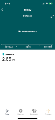

Just repeated my issue here to see if others came across this. I just started to use my new Charge5 3 days ago. I've got my Steps, Distance and Calories Burned data in total per day on the APP but when I dive into daily pages, I can't see any data on the graphic only with "no measurements" on it but I can check them through the Fitbit website. I'm using iPhone 12 and I've updated to the latest IOS system. I also tried to delete the APP and reinstall it, reconnect and synchronize my charge5, and restart my charge5 but still can't get the daily graphic data on the APP. Cheers!

This seems to be a problem with the Fitbit App on your iPhone. Have you tried restarting your iPhone as well?
