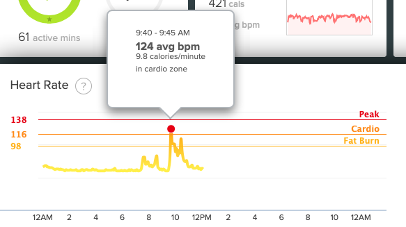

Keep in mind that when you are looking at a graph, whether on your phone or on the Web Dashboard, you are looking at a 5-minute average.
If your activity generates an exercise record, you may be able to get the granularity down to 2 or 3 seconds.
Case in point - my morning treadmill session - see the spike 7:51 into the exercise at 151 bpm?
Now look at the same time in the web dashboard (it is the same on my phone):
Two-second average against 5-minute average. HUGE difference.
I hope this helps.
