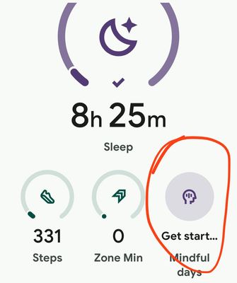

How do i remove mindfullness and/or add something i want to add

Welcome @KIAKings! It's great to see you around.
Thanks for the screenshot. Let me help you use the Fitbit app. To add or hide stat tiles please do the following:
- On the Today tab , tap the pencil tile Edit pencil.
- To add a stat tile, swipe down and find the stat you want to add tap Add. To hide a stat tile, tap the X icon on the stat you want to remove.
- Tap Done.
I hope this instructions will be helpful. Have a nice day!

@KIAKings The Today section of your app has several pre-set themes. You selected the Sleep better theme. Those four items are pre-set and you can't change them. There is a customizable option among the pre-sets. Please tap on the pencil icon in the upper right of your app. You will see the Sleep better option with a green check mark in the upper right, inside the margin. Swipe left/right and look for one marked Custom preset or words to that effect. Tap on the circle in the upper right of the grey area. Tap on the pencil icon in the upper left of the box. It will take you to a settings page where you can select your preferred metrics.
To be complete, the other themes are Get more active, Manage weight, Manage stress, and Improve heart health. I have been using the custom option ever since the app changed. I have exactly what I want.

Yes, thanks for the info
