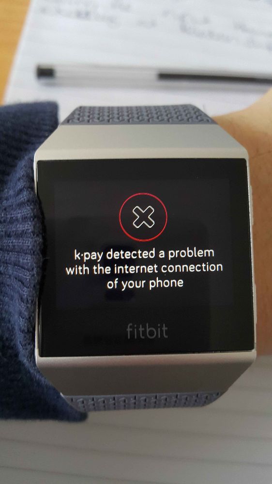

Started getting the message “k-pay dectected a problem with the internet connection of your phone”. Phone works fine. What is k-pay?

Ok, this is a problem relating to the watch face selection.
The one I selected was a 3-day trial and then required a payment to be to Kiezelpay.
Changed the watch face and the problem was resolved.

I'm receiving the same message. Cannot delete this message and it takes the place of my watch face. Help please.

Me too! My Fitbit is 4 days old and this message randomly popped up and now I cannot do anything. HELP!

Actually, I opened the app and resynced and all was well. However, moments later a message popped up from my clock face developer. I think the error might have been related to my chosen clock face (azzbyte "classic analog").
I switched from that clock face to another because I did not want to enter a code into some random developer website.
We we shall see if the error happens again.

Mine came up on my clock face. It took alot of searching before I found the solution was to not use the classic clock face.

I am having the same problem It is on the watch every time it pops up you can't get the clock back please tell me how to fix this

This is what appears on my screen. Anyone know how I resolve this?

Cant actually see the clockface anymore which is kind of fundamental to this actually functioning as a watch. There is nothing wrong with the internet on my phone either.

Same problem just started here

Thanks gone back to basic

I have the same problem.
I restarted the fitbit ionic but still the same. Help. Its annoying!

I figured the solution. The clock face you have selected is not free and it only gives you free days to try it then if you put your card info in the app, it will automatically deduct the amount or if the app can't, it will show error. So I changed the clock face and chose those free ones. They're gone! Problem solved.

It appears to be an issue with clocks faces from 3rd party developers. I have stuck with ones developed by Fitbit and have not encountered this problem again.
