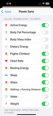

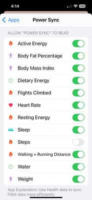

I did resolve it. In the Health app on my iPhone, I disabled the “Sync All” for Power Sync app and selected only the data I wanted to sync.
>From the Heath App, click on your photo or avatar in the upper right corner —> Apps —> Power Sync.
Uncheck “Turn on all” and then individually select just the data that you want (I suspect it was trying to sync data that Fitbit doesn’t actually track like BMI and Body Fat percentage.
Once I did that, it started syncing again.

Water is the one that kept crashing it.

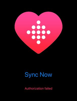

Unfortunately did not work for me. Keep getting "authorization failed". Not a big deal. Manual input only takes a few seconds. Thanks.
Mine was working for a bit and then yesterday it says “authorization failed”.

I just started getting the same thing within the past two days. Nothing I’ve tried works, including deleting and reinstalling the app and unchecking all sync info, or logging out of google (not I can log back in from Power Sync.

Same here “Authorization Failed” is the constant message - I think it is between the app and the Fitbit app, not Apple Health. Do you think Google has created the issue?
I’m having the same problem - I own the Fitbit bluetooth scales which are basically ‘dumb’ as I’m an Apple Watch & iPhone user.
I’ve been pushing my weight logs from the Fitbit app to Health using Power Sync app for years , using the free manual option - and 2 days ago there was suddenly an ‘authorisation failed’ message.
I tried logging out and back in, and deleting the app and redownloading and it hasn’t helped.
it now looks like it attempts to open Fitbit in a browser tab, & returns to the app with the failure message.

I’ve been using the “paid” version for years. First round of issues started back on August 12,  then a workaround was discovered.  This new issue is affecting the paid version as well.  Save your money until a fix has been provided.
I also note that on the App Store the last update for Power Sync was released 4 years ago which may mean we cannot expect any response from them. I think it is on fitbits end as I played around with settings in my Fitbit account, and now I just keep getting sent back to the “ PowerSync by Sunny Studio would like the ability to access the following data in your account“ page every time I click sync.
