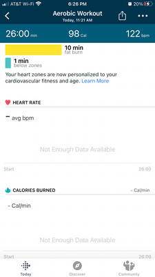

Since version 3.77 update Fitbit says not enough data to log avg Heart rate or Calories burned when tracking exercise

This started happening to me today prior to updating to 3.77. Updating to 3.77 didn’t change anything. I have a Charge 3.

@NanaPamJ @Jktn I still had v 3.76 yesterday and this happened to me, too. I thought this was from the switch to DST. This clock change can affect data on the Fitbit app. My heart rate trace from Sat - Sun has a two hour gap, not a one hour gap.
I'm hoping this is all fixed today.
UPDATE: I got the 3.77 update after my initial post. Then I did my morning workout and everything looks normal in my exercise details. The exercise details from 3/12 aren't fixed and I don't think they will get fixed. The time change corrupted the data. I am a Fitbit user since 2013 and this happens every time switch.

Yes everything worked fine the next day for me. Must have been the DST switch like you suggested.
