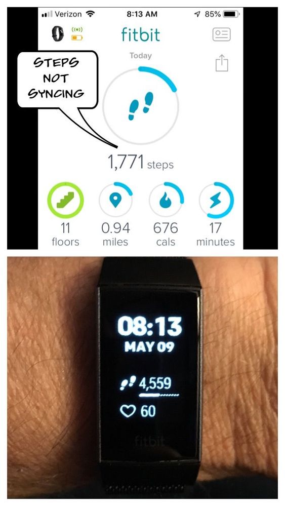

I have noticed that the tracker and the app seem to be one step behind on syncs. I took a photo of the app after a sync this morning, and it showed 1771 steps, but the tracker displayed 4559 steps. After force quitting the app and walking more steps, when I open the app and sync, the app now says 4559 steps, but not the additional ones just walked. Could this have something to do with it?

This first photo is a sample of the steps not syncing

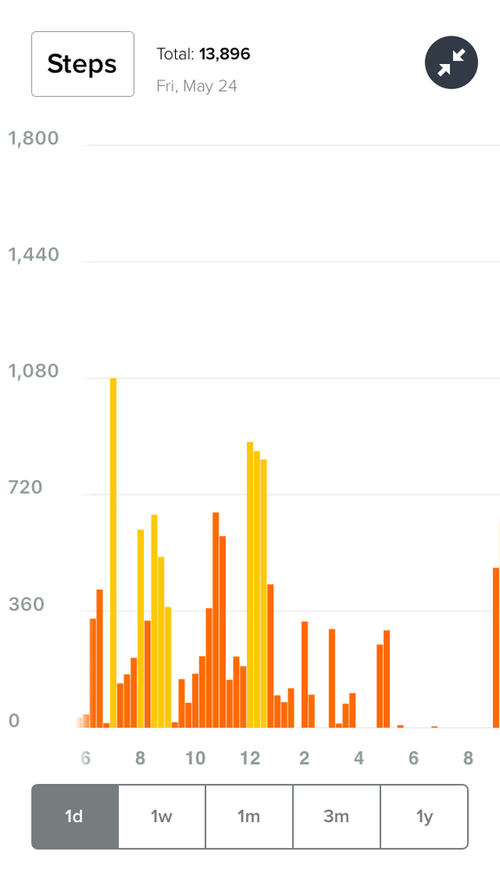

This photo shows the steps and graph on the main screen, and on the second screen. As you can see, on some days they match perfectly, and on others they are off.

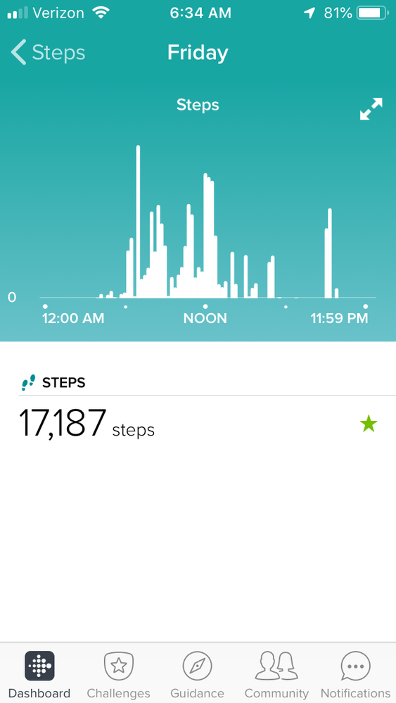

It appears nothing has been fixed yet. Here are screenshots from yesterday that have about a 3,300 step difference
